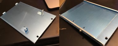

Here's the low-profile HDD mounting "plate" I intend to use, with SCSI2SD mounted on top for that ultimate in anorexic getup:

Sweet, thanks. NoPro on the inches. A 3" tank or anti-tank gun is 76.2mm, so your six inch ruler will be twice that for pretty easy scaling. Number associations can be very, very strange things. ::)
