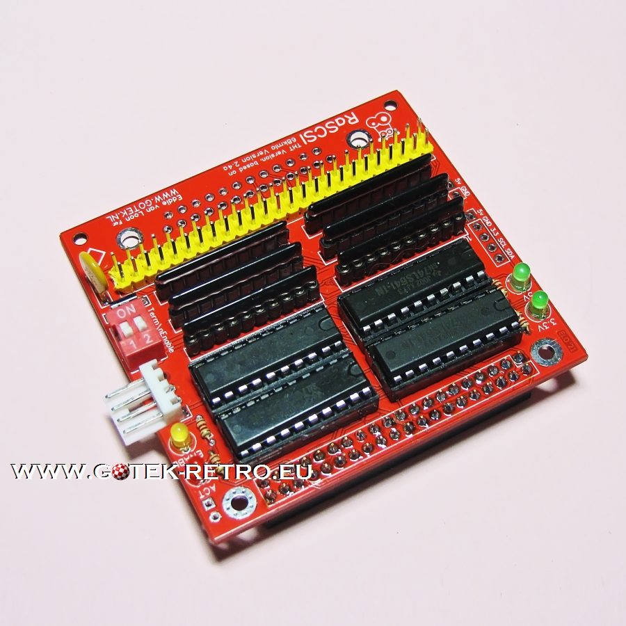

Sorry if it's slightly OT but, @landoGriffin , did you know that a Dutchman created a through-hole version of the Rascsi ?
Yep, the Dutchman in question shared their story earlier this year at the community Discord server.
It's a neat idea. For space is not a concern, I love non-SMD electronics for the ease of understanding the circuitry as well as tinkering/repairing.
