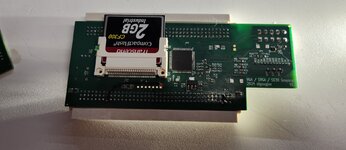

Latest update on this is I've hit functional completeness on the driver, after nearly a month of work, and now comes the fun part: extensive software testing. I did tweak the utility a bit more...even though it's a utility that most people will see once and never again (ideally), I added some more functionality to list existing volumes (if any) before wiping 'em. Oh, and it's got a name now: NuCF.
I've got some revised prototypes coming for field testing purposes, as well as a nubus bridge board to begin developing in that direction too. While the form factor is a revised version of my current prototype, electrically it is expected to be similar enough to the final design to allow for hardware compatibility testing.

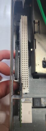

For the "final" PDS version I am thinking something like the below form factor: mount the card socket on the "rear", with the card overlapping (but not contacting) the eurodin on top. I said I was done with these blasted passthrough card designs and yet they're sucking me back in! I really hope I can manage this in 4 layers, though, not 6, as I'd like to make these as affordable as at all possible.
There's not really otherwise a great way to mount the CF socket without making the card taller, and this would allow a single design to serve SE/30, IIsi, IIfx. I tried on the protruding end of the card too, but I think it'd end up too long for IIsi and realistically no position allows for swapping the card easily. Given this is intended to be a fixed-disk replacement, I don't expect much swapping to be needed anyways. But, I intend to put termination resistors if possible as to not preclude the possibility of use with a CF-card extension cable. I don't intend to support hot swapping though.... That way madness lies.

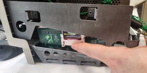

Small suggestion: why not mount the CF holder on an angle so you can access and slide out the CF card while the unit is installed in the chassis?
zigzagjoe
That angle does allow a straight pull in the IIsi and IIfx, but for SE/30 I couldn't come up with an angle that is any more accessible while being mechanically practical. CF cards seat into that socket firmly and it's not going anywhere without a good grip on it.

Probably worth seeing if the signal is strong enough for a CF extension cable to work. One of those could route it to the back panel.
