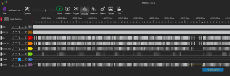

At maximum speed putting all else aside, the cycle time works out to 180ns on a 15.6672mhz bus. Or, 6 bus cycles per 4 bytes of data. This is leaving no time for instruction execution or storing data anywhere but a register. So that electrical signalling rate would be PIO-3 timings. In reality the effective transfer rate on SE/30 works out to 11 system clock cycles including the transfer to RAM (4 cycles), for a transfer rate of ~ 5.7MB/s assuming minimal delay before the card is ready to supply data (safe assumption).
On a 20mhz system clock (ie. IIsi/IIfx) the timings are a bit faster than PIO-3 at 150ns cycle time, and a 75ns IOWR pulse. By default this requires PIO 4 then, though realistically as the various PIO levels just guarantee certain minimum timings there's nothing wrong with running a bit slower (PIO 3-ish timings) since the card supports 4 (or beyond). So with the same 11 clocks to move 4 bytes of data from card to RAM that works out to ~ 7.3 MB/s max transfer rate.
With a more complex hardware design it might be possible to take one or two cycles off the CF access time, but that would very much be a diminishing returns situation given that bus cycles are cheap on PDS and the improved small IO performance is what really helps us. However, on NuBus where bus cycles cost more that 32 bit expansion makes more sense (ie. support longword reads in hardware).
This is why bus mastering (DMA) doesn't make a lot of sense in the 030: making idealistic assumptions (32 bit CF access in 4 cycles) this would lead to 8 cycle transfer rates or 7.8 MB/s assuming the DMA hardware didn't require any time to sequence the additional accesses. However, the CPU would be equally unable to do anything productive during sustained transfer and care would need to be taken that the card doesn't hold the bus long enough that IRQs start piling up. Meanwhile, on the Mac OS side just about the only thing productive that'd really be possible with that extra CPU time is mouse movement. The card's just tripled in complexity (or more), and the driver would have to be more complex with not much gain to show for it... so the PIO method of access is appropriate enough here, IMO.
