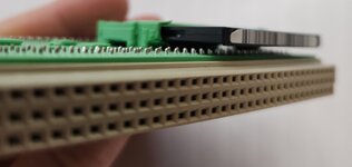

Test boards are in the wild! Production PCB design is also done, barring any findings from testing.
Physical fitment looks good. In the IIsi case, need to be slightly careful when reinstalling case that the card is upright, but otherwise good.

It looked like it, but I think it’s just a physical analog. To ensure proper fit. Think the space shuttle pathfinder.
zigzagjoe
Is that a 3D printed conformal coating? :D
Haha, that'd be cool but no, I just exported the PCB from Kicad and printed it, then stuck eurodin connectors on it. I admit I was surprised that the CF slot worked with just mild cleanup with a scalpel, I didn't put supports to help it.
I had already checked that the slot being there didn't foul anything when coming up with the concept, but it's reassuring to double check as it's slightly thicker than apple's recommended maximum component height on the rear. I won't get to have a first run of the "production" design in hand for probably another month or so, and the waiting is going to kill me!
croissantking
Ah, it’s a mock-up to test fitment! I totally thought you’d printed a green cover for the back side of the PCB.

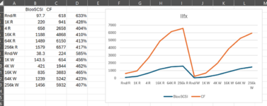

Some updated benchmarks. A bit of variance in the CF numbers are normal, and of course depends on the card itself. These are all with InnoDisk ICF9000 industrial SLC cards as I've found them to be fastest and are spec'd for heavy use. The random access numbers are the most important ones, and it's pretty clearly a massive improvement there :)
The odd Carrera behavior can also be observed. Diimo makes a little sense as it latches the data from the system bus before issuing the internal DSACK (so there must always be reduced speed due to that, as compared to a booster) but whatever the Carrera does is clearly worse on reads, though I think it has a posted buffer for writes.
Initial operation in IIfx is confirmed with the addition of a bodge wire. For some reason apple thought it was logical to feed 20mhz where C16M (C38) normally is and have no CPUCLK (A38) at all. The actual 40mhz clock is missing, too. Either way, the production card will fix that.
Here's some tentative IIfx numbers. Clearly, fast as all get out.

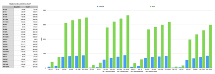

jmacz
MacBench 3.0 disk tests on a Macintosh IIfx (stock 40MHz 68030) with 128MB of memory, two video cards (8*24GC, 8*24), internal ZuluSCSI HomeBrew Compact with a 64GB PNY Elite-X V30 micro SD card with 1GB disk, and the NuCF with 2GB partition on the CF card. Ran test first on the ZuluSCSI and then ran tests again on the NuCF. Both ZuluSCSI and NuCF were installed in the machine.

Insane benchmarks. Love it
