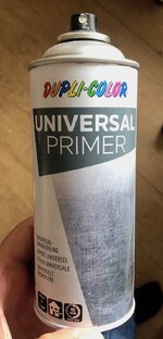

MacUp72
yeah, that Macintosh off-white.. maybe you could give this simple primer spray a try, turned out quite ok with my 190c..
