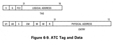

Aaah, I assumed the '040 was the same as the '030. I'll look up the '040 on bitsavers. Started to do that - so maybe given that System 7 only came out in 1991, they already made it '040 compatible? Do you know what the Apple VM page table structure was then? Do you have a link to that info? It's astounding how different VM mechanisms are, e.g. the MIPS R3000 basically did everything in software (you just get a page fault exception), but the address space is divided into 4. x86 I thought basically kept it upward compatible until x64. ARM's original MEMC was very bizarre, but the later ARM6 and ARM7 etc had a 3 level structure I think (with variable block sizes).
Gosh, the '040 has a 2-bit Physical address extension! 16GB! Oh, it still is quite a bit different, because the M88K is 10-bit segment table + 10-bit page tables, whereas the '040 is 7-bit TIA + 7-bit TIB + 5 or 6-bit page tables. But I can see that on an '030, you could define the TIA and TIB as 7-bits each and then TIC as 5 or 6 bits, with 8K or 4K page sizes.
Anyway, thanks for continuing to reply and help me reduce my Motorola MMU ignorance :) !
