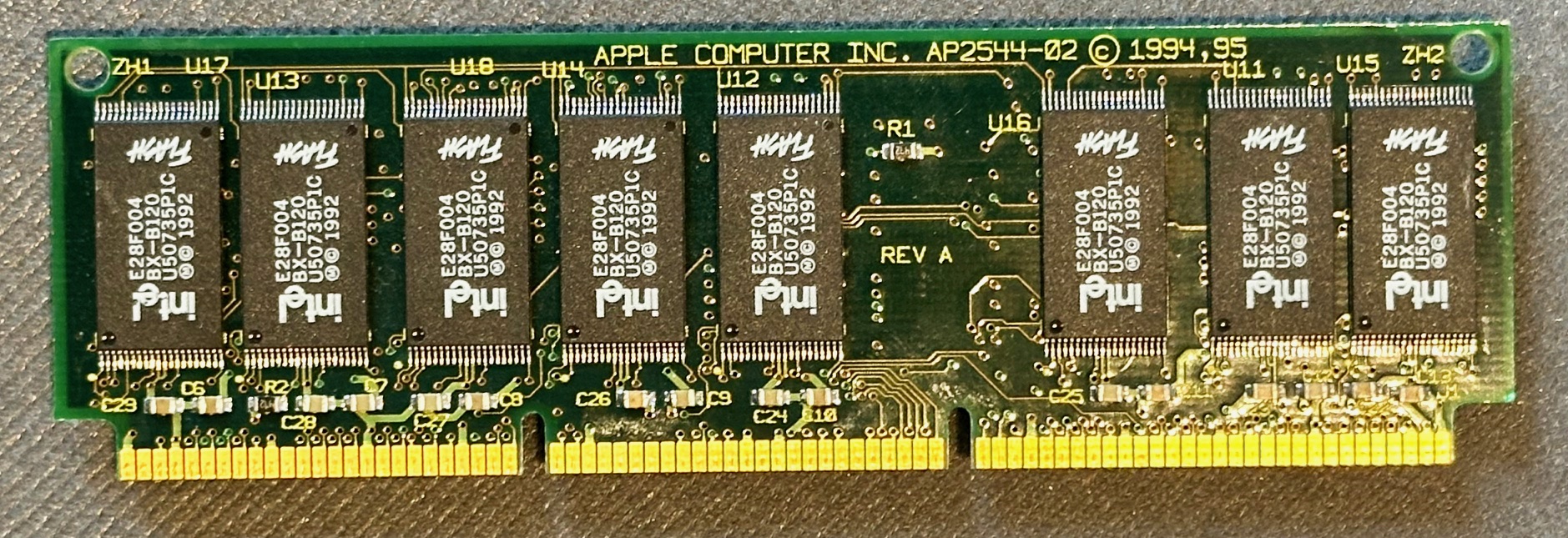

@Phipli pointed this CD out to me a while back. I haven't looked at the older versions, but the newest one has a table entry that matches against the 7500, 8500, and 9500. I haven't gone in depth to figure out how it works. I believe it would be compatible with a ROM DIMM that has sixteen Am28F020 chips on it for a total of 4 MB of ROM. That would be a crazy looking ROM module...

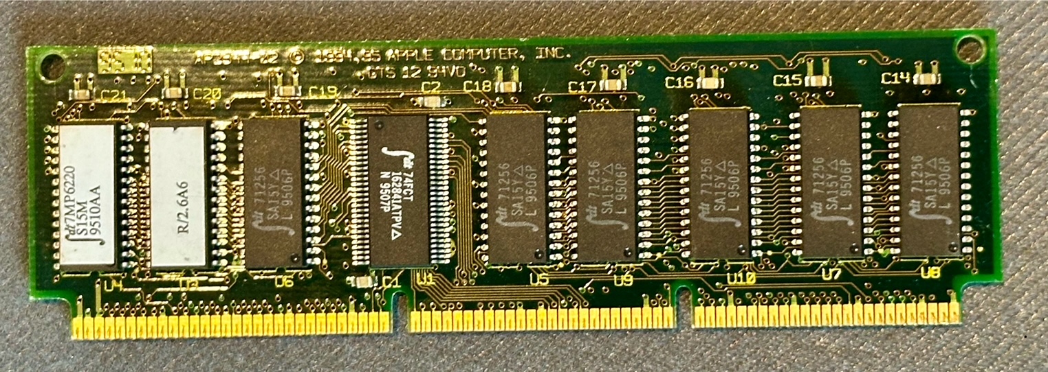

And it worked! I can both read and flash using this PDS programmer my red ROM from an STB. It should also work with the Lobos card, and maybe some others that I'm not aware of.

I'm so glad you were able to verify it with the STB ROM SIMM. It makes sense because the table entries showed that combination as being supported.
It would be nice to figure out how the STB SIMM is wired up and what the 74F86 chip on it does. I'm thinking that it's going to be creating chip select signals for the two different sets of 4 chips based on one of the address pins. One will be the inverse of the other.
