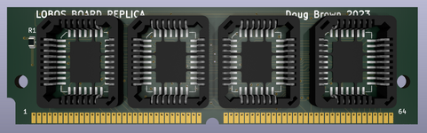

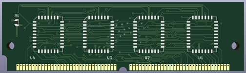

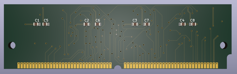

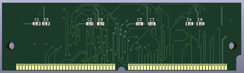

So...I did a thing this weekend and created a replica Lobos board in KiCad. My head is spinning, but I just finished matching up traces and vias to @Performa450's original pictures from this thread. I got a little lazy toward the end shoving things out of the way to make room for the last vias, and it's definitely not a perfect match, but it passes DRC! I'll probably order a few of these soon. Not sure I'll have much motivation to clean it up and turn it into an exact replica since it's just an experimental thing.
I also ordered some Am28F020 chips on eBay, and I have an Xgecu T56 programmer (this wouldn't work with anybody's modern ROM SIMM programmers due to the chips needing 12V for VPP, not to mention pinout differences). I need to scrounge up some PLCC sockets, and then I should be able to build up a few of these and test out the flasher utility in a real Mac. We'll get to see exactly what it was like for Apple's ROM developers to reflash their Macs in-system during development!
This doesn't really have any practical applications -- it would make way more sense to hack the flasher utility to work with modern ROM SIMMs that use chips that are actually available these days. Or maybe make an entirely new program for in-system flashing instead. But I still wanted to do this so we can see the unmodified original flasher utility in action!

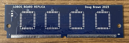

Lookie what showed up today. I'm excited to build one of these up and try it out with the Flasher utility! I have my Performa 630 all set up to attempt reflashing this SIMM in-system.
Excellent :) let us know how it goes. I'm very curious to see the projects this enables with 475s, 630s and 650s etc.

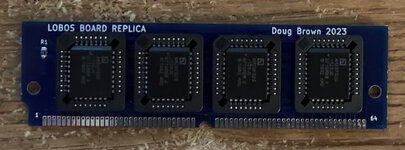

I have an update. I really need time to clean this up and present all this info in a nice organized manner on my blog and/or YouTube, but here's a sneak peek for 68kmla. The gist of it is: my Lobos SIMM replica works, and I was able to program it in my Performa 630 in-system using the Flasher app!
Here's what it looks like in the Flasher app with my replica SIMM installed. I programmed the four chips with the stock LC/Quadra/Performa 630 ROM using my T56 programmer to get things started. Notice that the program now detects a programmable "AMD 28F020 x 4" SIMM whereas previously it would say it was a Read-Only ROM. I also loaded a new ROM to flash with the "Open Image" button.
Then I clicked Program and it asked me to confirm:
The actual programming process was pretty boring, which makes sense. It can't access anything in the Toolbox to display anything fancy, since that would be in the ROM that it's upgrading. So it just displays an "Upgrading..." message, which it probably draws before actually starting the process of erasing the chips.
It looks like it's stuck and doing nothing, but it's really erasing and rewriting the flash chips behind the scenes. After about 10 seconds or so, I heard a boot chime even though this screen was still up. My "630 New ROM" file changed the boot chime, and that's what played, so at this point I was confident it succeeded!
The upgrading screen stayed up after the chime for a brief moment before it cleared and went forward with the normal boot process. When it booted back up, it warned me about shutting down uncleanly, which makes sense -- can't shut down cleanly if I'm upgrading the ROM.
All in all, great success! It definitely seems feasible to do the same thing this program does, but with newer chips that don't require VPP. Either by making a replica program, or hacking the code in this program. I still think hacking this program would be super cool because you would be using the same program that Apple's own developers used back in the day :cool: But I don't know if I would be biting off more than I can chew.
