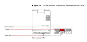

    Do I need a SCSI terminator for the Apple HD SC if it is the only device on the SCSI bus, and the Mac Plus it is connected to has the termination power diode installed?

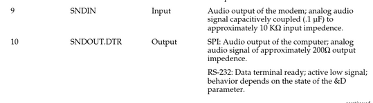

    Could I use a PowerBook with the internal modem as a regular phone on the analog phone system? Probably not...?
    luRaichu
    luRaichu
    What about the PowerBook 180?
    H
    halkyardo
    I don't think any of the 100-series modems supported voice, no - they have an audio output to the speaker for line monitoring, but no audio input capability.
    luRaichu
    luRaichu
    From the PowerBook 160/180 developer note. It looks like you can send and receive analog audio on the line if you have an SPI modem. So you can probably use it as a phone

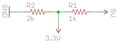

    What's a cheap, easy, and super compact way to step down a 5v signal to 3.3v without a logic level converter? I'm not doing serial or any complicated communication protocol, it's just an on/off switch basically. and I only need one-way functionality
