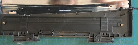

@AEChadwick, looking to make my own, custom fix as well...but I am wondering if the screw bosses actually contact the flat back of the case inside the standoffs...or if they are "raised up" a bit...can you say?
if i understand the question...

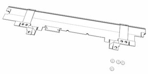

this is designed to re-use the existing bosses; melt-push the bosses into the holes until they are flush to the face of the printed shim.
at that point, the bosses will also be in contact with the existing case-wall. to wit, the shim is the same thickness as the bosses.
this is only a little funky around the single boss that screws into the clutch--the shape is a little weird there--but it should still work the same: flush to the shim face = in contact with case back (fill any gaps with glue, etc)
let me know if that helps. (if i have a minute, i will go pull a lid apart and point.)
Thinking back, I don't think the bottom one in the "well" so to speak of the housing reached the bottom - it was shorter than the others.
can you clarify what you mean exactly? is your question if the brass screw inserts are fully sunk into its correponding holes, touching the actual back of the display housing?Just compare how deep they are now, thats the height/position they need to be afterwards, otherwise the screws cant reach them correctly.
this how it looked on mine, I used the same stl file. When it is glued in, the correct alignment of the new and old holes' position underneath is crucial. The height of the shim is the same as the old standoffs.
Yes that is exactly what I am asking. I need to know if they sit against the plastic all the way in those standoffs. If they do, it will make what I’m doing much easier.
well, make sure the the shim sits correctly, otherwise alignment wont work. I marked the position of the old standoff holes with a silver marker before, so I was sure the new holes wouldnt be off. Then glue it down. Then I just put the brass standoffs on a hot soldering iron for 5 seconds and pushed them in the holes..the depth is the same
