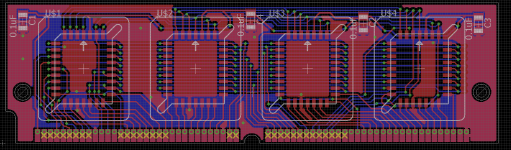

Board:

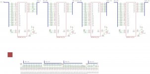

Schematic:

I thought the original design dougg3 made used standard eeprom chips that you can pop in and out. I believe that design is open source.
There was someone who didn’t know what they were doing trying to undercut his later 8mb design, which is somewhat difficult to make for a hobbyist anyway, but it didn’t materialized. However, that one requires a specialized programmer. I think that design is also open to make yourself, but the chips are hard to find for a reasonable price.
trag
On this kind of design, I would recommend either making the sockets through hole, or putting two chips on the back and two chips on the front of the board.    It's almost impossible to hand solder the surface mount sockets, because of the center plastic piece, most folks aren't going to solder paste and toaster oven a board at home.   Spreading the chips on both sides of the board leaves a lot more room between the chips for soldering.
So, make it through-hole, folks must use sockets, but they're pretty easy to solder.
Or put the chips on front and back, and there's plenty of space between them for soldering the chips directly to the board, but not such a good design for a socketed board (because of difficulties with two sided solder toasting).

I got a tube (32 pieces?) of thruhole sockets for the 20pin version of that PLCC socket on eBay. It might be worthwhile tracking that part down somewhere. Muuuuch easier!

I never really had an issue with PLCC sockets, you just cut out the center and solder it like this:
The main issue with through hole PLCC is that the pin arrangement is horrible for multiple in line chips. It's possible but very very ugly.

BEHOLD THE VERSION FOR THRU HOLE PURISTS
MINIMALLY AUTOROUTED ;) ;)
ADHERES TO SOME SIGNAL INTEGRITY STANDARDS
UPLOADED TO GITHUB

Autorouter? I dont think I have ever used an autorouter when laying out PCBs. I am sure powerful packages like Altium, etc have powerful autorouters, but the one in eagle is awful. at least thats been my experience.
My portable RAM card was all done by hand.
K55
The prorouter in eagle is nice enough to get the job done. I use it for isolated runs of a few traces when I've handfit most of a board to speed up work.
