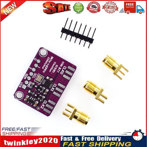

For any experimenting with clocks is it worth getting one of these and knocking up a circuit?
The output is 3.3V so you'll need something fast like a SN74AHC1G08DBV to level shift the output to 5V plus an AVR or similar to set the speed.
This might be overkill :)
