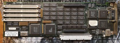

I've got one that says: SPECTRUM SE/30 (c)1989 on the PCB, but the ROM's stickered:What SE/30 card do you have?
