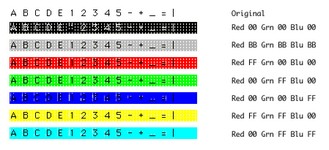

I took various screenshots of the window area in question:
The first row is a screenshot prior to any highlighting, etc. The second row is me going into photoshop and for every pixel that is fully white (0x00FFFFFF), I forced the color to red. As you can see, there's artifacts already even prior to invert+hilitemode. The third row is with the invert+hilite. The fourth/fifth/sixth rows are the same without the text -- I tried this to figure out whether the issue is with DrawString() or whether it's occuring for pure white backgrounds. But clearly it's happening everywhere.
What is weird though is I would have expected row 2 and 3, as well as row 5 and 6 to be the same! ie. all non-white pixels are left alone using the invert+hilitemode but that's not the case either. This doesn't make sense to me. I then thought perhaps the noise was changing on its own? But that's also not the case. The non-white pixels are consistent over the duration of my testing and the invert+hilitemode always results in the same thing also. Huh?
I then created a new folder in the Finder and made it fill the entire second screen and took a screenshot. Then again filled in all the pure white pixels as red to easily see the non-white ones:
Even in this blank window, it's not all white. Note that I only converted to red in the window content area but the title bar, scroll bars, all of it has the same issue. But here's another clue, clearly the bad pixels at least in this window have occurred following the mouse cursor?
Learnings from these experiments today:
  • Doesn't seem to be the SQD-01 chip that handles accelerated functions.
  • Doesn't seem to be the invert+hilite mode call anymore.
  • Seems to be tied to the blue channel which based on my prior tracing seems to reduce the problem area to 8 of the 24 VRAM chips.
  • Doesn't seem to be an entirely faulty VRAM chip as it's not across the entire screen.
  • Seems to be every 4th pixel column.
Seems like a faulty read from one of the blue VRAM chips but I'm lost as to why the invert+hilitemode vs the bad white pixels doesn't match up properly as I mentioned earlier.

Screenshot... steps:
  • Filled screen with white directly writing into the frame buffer.
  • Took first screenshot and filled all TRUE WHITE in red.
  • Moved mouse over left edge of monitor.
  • Took second screenshot and filled all TRUE WHITE in red.
Before Mouse (everything is white)
After Mouse (path has artifacts)
Again, looks like every 4 pixels. I believe the way these cursors are drawn, it's essentially an XOR. Looks like for whatever reason, the XOR isn't working quite right?
I took a look at what the pixel data showed in two tests:
  • 1st Test: Fill screen with white
    • Pixels should be all white: 0x00FFFFFF
    • After mouse passes over, the bad pixels are: 0x00FFFFF0
  • 2nd Test: Fill screen with red
    • Pixel should be all red: 0x00FF0000
    • After mouse passes over, the bad pixels are: 0x00FF000F
Looks like the XOR on the least significant 4 bits of the blue channel is not working quite right.
This issue is consistently reproducible which suggests to me that it's not some noise issue. It's possible it's not a blue channel issue either -- but possibly an issue with the operation on the least significant 4 bits of a value.

  • Verify those pixels are pure white (all good here).
  • Use quick draw operation (used both PaintRect with patXor and also tried InvertRect) to invert the window contents.
  • Verify directly from the frame buffer whether all pixels are pure white (bad result here).
Again, it's every 4th pixel column and it's the lowest 4 bits of the blue value which is bad.
Wrong again 🤬 I got so tied up with HiliteMode initially that I've been stuck thinking about things associated with it, hence most recently XOR operations. But it's not that either because I just implemented an iterative XOR in software (to rule out any special handling of XOR in the hardware) and I see the same issue... which then led me to just do simple writes/reads and I'm seeing issues there as well (but not in all cases).
Latest
  • Indeed is the least significant 4 bits of blue.
  • In fact, it's actually the 2nd bit (ie. 0x00000002).
  • Every 4th pixel in my blit is having this issue.
  • BUT there are cases where it doesn't happen, for example all black, all white, some other patterns.
It's probably a function of another bit either in the value or in the address (the fact that it's every 4th pixel suggests it's an address line) so looking for that pattern now. But looks like I have damage to one of the 8 blue associated VRAM chips on the board. I'm going to assume now that at least in 24 bit color, it's 1 bit of blue per chip.
If there's a VRAM problem, then there would be issues more visible with 1,2,4,8 bit color? Or does the card only do 24 bit color?
The card does support all of those bit depths but I only see the issue on 24 bit color. I'm not quite sure how SuperMac utilizes the VRAM chips in each bit depth but from mapping out the card:
  • Group of 8 "red" VRAM chips, all wired to talk only to the "red" BSR chip, which is wired to only the 8 red pins on the RAMDAC
  • Group of 8 "green" VRAM chips, all wired to talk only to the "green" BSR chip, which is wired to only the 8 green pins on the RAMDAC
  • Group of 8 "blue" VRAM chips, all wired to talk only to the "blue" BSR chip, which is wired to only the 8 blue pins on the RAMDAC
In 1 bit mode (B&W), I see only the 8 "red" VRAM chips being utilized. I've tried shorting the green and blue chips' outputs and none of them affect the screen while in B&W, only shorting the red chips' outputs do.
After spending time running various additional tests, I have narrowed it down to:
  • Bits 2, 3, and 4 of the blue component are the ones that sometimes have issues, none of the other bits are showing problems.
  • None of these 3 bits have issues when outputting a stream of the same color. ie. all black, all white, all blue, all green, all red, etc don't exhibit the problem. These 3 bits don't have to be the same, just if they stay consistent across pixels, they seem to do ok.
  • If it's not a stream of the same pixel value (eg. randomize the pixels), then some combination of those 3 bits get the wrong state.
  • Haven't figured out what the pattern is yet.
  • But it's consistently the same addresses having issues (every 4th column) so it could be 1 or 2 of the VRAM chips have some problem.
I should be able to use my logic analyzer or quick and dirty shorting to figure out which of the VRAM chips is responsible for the pixels I am having issues with. From there, hopefully make some progress on whether it's the address lines going into the chip or the chip itself.
OR I could be heading down the wrong path again. We'll see.
