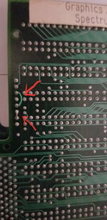

My accelerator daughter card is Rev C and it has 2 reworks on it. You can find these under the paper backing. I think these reworks were rolled into a later revision of the accelerator daughtercard.
