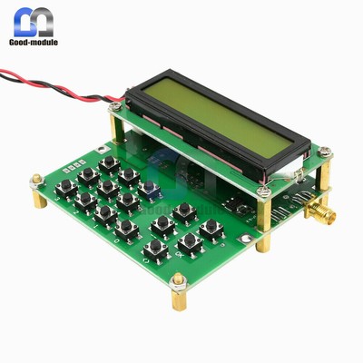

I got the 40 & 50Mhz for $1 each. It would be nice to have a mini-LCD with an intuitive selector - maybe 3 digits and an M/K, etc.
These exist, but I don't know how usable they are in terms of quality, cable lengths etc :
$1 is good going for small quantities! All my local wholesalers seem to have £20 minimum orders for free postage these days so I end up paying inflated prices on ebay.
