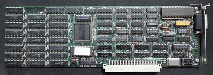

I bought this old SuperMac graphics card on eBay. I knew it was going to be an early card, given that it nearly contains only through-hole parts.

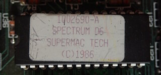

The ROM label is interesting, in that it says "SPECTRUM" but not "/8" or "III" or any additional modifier. I assume 'D6' is the ROM version. Looking at the raw ROM file reveals the version to be 1.0b6. So, a prerelease ROM? Given the mid-1987 date codes on some of the other chips, I think this is a production release.
With the card installed, I was in for a bit of a treat. 1024x768 resolution in 8-bit color circa the launch of the Macintosh II. Wow! I was sure it would be only 640x480.
Although no driver is required, the SuperVideo software did not work with such an old ROM.

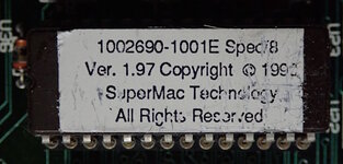

Someone was selling an identical board with a v1.97 ROM. (The seller said this card had weak color, but it seems to be an issue with choosing the correct sync settings. The color is beautiful with @bigmessowires Mac Sync-inator. There is some waviness which the first card doesn't have. I assume something has aged poorly in the second card.)
Not sure what that copyright date is. I think 1990. I copied a '0' from the part number and made it partially transparent. Seems to fit.
With the newer ROM, the SuperMac software works. There are seven resolutions / frequencies which can be enabled if the correct crystals are installed.

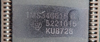

The Texas Instruments chip is blacked out on both boards. Any idea what would remove permanent marker but not the chip markings? I understand the TMS34010 was popular at the time, but that number doesn't quite fit the markings.

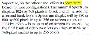

Looking through old issues of MacWorld, the first mention of this card by name is July 1987. By the way, I didn't see an 800x600 setting in the SuperVideo software, so maybe they didn't ship that configuration.
But, later in the issue the card is called "Spectrum 1000/1" and "Spectrum 1000/8".

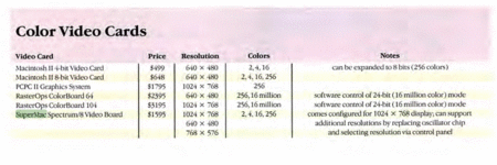

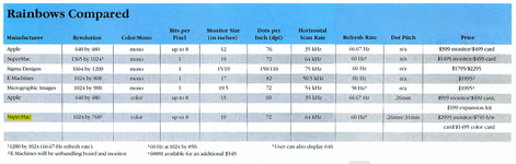

In that same issue, here is a comparison of the competing cards around the time of the Macintosh II launch. The card and monitor would set you back $4500.
A year later, RasterOps caught up with color cards, including millions of colors.

I count 24 NEC D41264C 4bit x 64k dual ported VRam chips - 768kb VRam. I guess that‘s not enough for 24bit even at 640x480, you need 921kb or simply 1mb.
