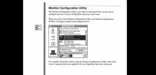

Yes - you can decide to use any of the included pre-defined resolutions as the basis for setting up a custom monitor with an alternate timing. The H and V resolutions are just used for timing calculations. I do not think you can explicitly enter HA and VA as a manual resolution. The sRec resolution in the scrolling window at the top is what tells the OS what the base resolution will be. So, you can decide that HA and VA need to match the chosen resolution from the scrolling dialog window, etc. And, further, you can set timing parameters that result in a different visible area than the one you have selected, but if you do that, the OS will still think the resolution is what you selected from the scrolling list and you just won't be able to see all of it.

Manual extract from the first page of this thread.
You can just select it. Might be worth reading the PDF I shared a little while ago.
