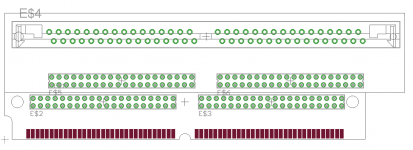

The graphic that got you laughing is the current iteration of the dummy SIMM end of the extender.
This one gives a better picture of the two halves, the board will be cut cut across the middle.

When I did this quick study, I thought I'd need to use three standard IDE cables and headers for them at each end of the testing units. When I researched the newer ATA cabling, I cut it down to two connectors/board. I'm going to take a nap and fire up Illustrator 8 again tonight.
1) Move the dip plug sockets together and lower on the board to bring it in line with DQ's ROM SIMM form factor.
2) Continue the traces on to the Dip Plug sockets and SIMM Slot end of the extender Cable.
3) Continue those traces on to a 64 position machine pin socket for homebrew programmer adapter development.
4) Continue those traces on to sockets for:
________ the yet to be identified DuoDock ROMs . . .
________ the PLCC ROMs for the MiniDock and my Radius VidCards . . .
________ bbraun's suggested EEPROM package . . .
________ the 28pin EPROMs used on most early Cards and peripherals . . .
________ whatever other suggestions come up . . .
________ and just maybe . . . the friggin' kitchen sink! [:o)] ]'>
Other than some patch wiring for the adapter connections, It's pretty much a single sided board that doesn't need any plated thru holes . . .
. . . should get three sets ganged on a 12'" x 12" blank . . .
. . . dunno, we'll see, I've got a couple more notions rattling betwixt the earlobes, ATM. :scrambled:

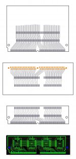

I see... sounds like a good idea for a feasibility study. I'm not knocking any ideas around here, most experiments have the potential lead to new discoveries or ideas. :b&w:
The extender could also relate to the idea of extending the CPU socket or PDS slot for the Daystar crowd, right?
Ok, gang, here's the concept study for the extender project as it now stands.
Criricism-n-suggestions of every type are encouraged and will be much appreciated. :approve:
Input signal flow is represented in the diagram as from bottom to top and each cards is shown as a discrete unit. The actual layout is still single sided. for a one of the three ganged cards in a row of the three triplets on the 12" x 12" copper clad FRP from CrapShack I'm still hoping to find in one of the boxen. The top card will be rotated 180 degrees so the edgecard connectors are on the opposing side of those on the bottom card. Other sourcing suggestions for inexpensive fab on a one square foot, max size, blank will be considered.
______________________________________________________________________________________________________
The top card is a parallel, peripherally related, development that's a gimme in the production process. It's intended to make adapting dougg3's programmer board for use in building "standard" format adapters for individual or ganged ROMs in alternate IC packaging by the traditional process. The loose traces will lead to the four different socket types discussed earlier, wire wrap or soldered patch wiring will be necessary unless I move to a double sided, plated thru hole process on a blank of the proper thickness. I'm assuming that this will be prohibitively expensive, prove me wrong PLEASE!. Funds for the toy account are unbelievably tight for the moment. I also don't like the idea of learning to run a real PCB Design App, but doing so for the three cards individually ought to be doable with the free version of just about any program if it comes to that. My brain's PFPGA is burned in or the Adobe Illustrator graphic arts approach, which it perfect for my homebrew PCB fab processes.
The other pair of cards are the extender boards, the main line of development. They'll be connected by standard IDC DIP Plugs in the sockets on the boards. The DIP plugs will be hacked to achieve alternate ground lines on a doubled cable mod during the ribbon cable punchdown process. Description of hack above. I may or may not flip the signals on one to equalize cable/signal runs for timing, probably so, but this way is best for clarity's sake ATM.
TIA, for any and all help.
jt :beige:
