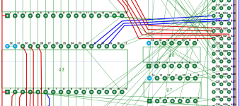

This is just a really rough stab at the lower end of the board with 2 layers. You might need to jumper some connections with wires in the worst case scenario. The upper area gets hairy... I think the chip spacing needs adjustment, I move some of the smaller ones down. I cheated with the vias and swapping layers, so some places might show an overlap, but the idea is there. It has been years since I laid-out a PCB in Eagle, but it seemed way easier to move components and swap layers while routing.
The vertical traces on the left side of U1 should probably be blue....it's an iterative process...
Wow, that's amazing tt. I was wondering if changing orientations of the chips would help, but from your pictures, it seems like that isn't necessary. Thanks a bunch for taking a look at this, what you got done in less than an hour... I'm not sure I'd have figured that out in weeks of staring at this.
FWIW, on the many boards I've inspected a/o collected, the ICs for I/O/Glue are normally parallel to the expansion slot connector. Memory buses can run either direction, but the ICs are perpendicular to the board connector, with the buses parallel to it, for most high capacity designs I've seen.
Remember, these are only casual observations on my part. :beige:
Thanks, I hope it gives you some ideas, there's stuff I think could be better, but it is sort of a conceptual layout to see if 2 layers is feasible. Hopefully the design rules are not violated with the routing between pads. I can look at the upper part more sometime later, I am a little tied-up at the moment. But my approach is to look at general groupings of paths in the rat's nest and then see if they can be out of the way of the other groups. I see the upper right as having a bunch of intersections that will probably need a ton of vias unless a change in the chip layout could mitigate that issue. I am feeling constrained by the software, so I need to learn how to use it better within its workflow.
Note for later: Do you have the board size maxed out? If not, I would make it the max size for the board-house price point and fill the leftover area with a bunch of plated holes at 0.1" spacing for soldering other stuff later.
