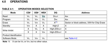

Best case scenario, these flash ROMs are somehow incompatible with this machine, but that just seems too good to be true at this point, and I have no evidence to support this. They follow the right JEDEC standard, have the correct pinout, and their write pins are correctly left unconnected. I figured they would qualify as drop-in replacements for the IIci's mask ROMs. I am worried that something is instead wrong with my ROMSEL/ROMDEF circuit or worse, UK11/MDU.
