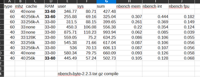

Some benchmarks from netBSD - compiling nbench. The 060 is running at twice the bus speed listed (mhz) due to clock doubling.
As far as nbench is concerned, this 80mhz 68060 is turning in 1.5x the performance of a pentium 90 in purely integer workloads. The FPU is, of course, another story, and when memory performance is more in focus (sorts?) the 060 falls behind.
The Pentium is on a 60mhz 64 bit bus as compared to a 40mhz 32 bit bus which is more 486-like, and the comparison extends to video: the quadra framebuffer is essentially a 486 Vesa local bus video card without acceleration. This is not ideal as far as the 060 is concerned, but it's the closest thing to a period 060 design without design major compromises. In another timeline this could have been shipped as a viable machine.

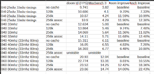

Here are some more Mac benchmarks. This was mostly exploring the benefit of 128K cache vs 256k cache vs 256k 2-way-associative cache.
This cache board was originally designed as a 256K direct mapped cache as an upgrade from the usual 128K cache boards. However, the changes required to support the additional capacity made it a relatively simple bit of bodgery to change it into a two way associative cache using a random replacement policy. This makes it somewhat more resistant to cache thrashing and I couldn't resist digging into how that changed performance. It seems like the 040 is fairly happy having any cache and the additional capacity didn't help all that much, but the more bandwidth constrained 060 benefited more.
Note: the 33mhz/60ns timings in these screenshots refer to the Quadra 800 33mhz 60ns RAM timings, these are notably more aggressive than the 80ns timings used on the Centris/Quadra 650 and provide greater performance. They are a minor overclock when running at 40mhz bus speed. I'm running 128MB of 40ns RAM, so I've got a little room to push it :)
