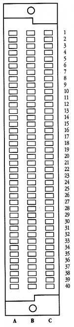

I'm looking at my Radius "SE30 Bus Adapter" and it has the 1-40 row numbers going the other direction, basically A1 in the top-right corner for the orientation of the board you posted. Not sure if this is an issue...
I think so...it the notch/naming on the Radius board seems to agree with the GttMFH. Trash can check too, I think he has the same board.

tt: Thanks for catching that, I think I've corrected the orientation. I've updated the project file with the renumbering change.
Cool...It looks consistent with my artifacts. :)
But....you forgot to include the right-angle pass-through connector on the other side. :o) But now I'm reminded of a question I've had, is the PDS slot completely parallel if you want to add more slots say for a dummy adapter that Trash has brought up?
