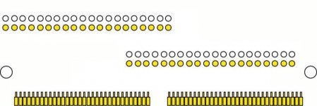

I've been looking more and more into fabbing a few PCBs in house for the extender project . . . it's already growing in scope and size. 8-o
I figured that I'm roughing out the connections between the two halves of the extender as if they were one long extender in and of themselves. It occurred to me at work this evening that I should add pads for a few accessories while I'm at it. A 28 Pin ZIF Socket to handle the Quartz Windowed DIP EPROMs common on NuBus and PDS Cards, the PLCC sockets for the EEPROMs on my Radius Cards, the DuoDock, Duo MiniDock and the whatchamahoozit socket for the ZIF mounted EEPROM in the DuoDock+ just for schiznits-n-giggles.
Basically, I'd like to be able to install the ROM SIMM end of this contraption into the SIMM Programmer's Slot and install one of the above (E)EPROMs into the appropriate socket to read and copy to disk for hacking and/or just writing it to another ROM. Getting the DuoMiniDock DeclROM repackaged and into the DuoDocks has been a long term goal of mine. [}:)] ]'>
Does this sound doable in the SIMM Slot of your programmer, DQ?
