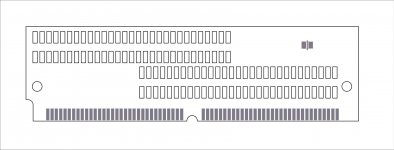

OK, I see what you're saying. Actually I'm cool with leaving the flash chips (and possibly an FPGA) on the SIMM as well and then putting other stuff in a FDD bay, or even something closer to what you described in your instructions (very nice detail, thanks, I get it!)
I think I'm going to have to leave the hardware hacking/testing for someone else to do though if they want :) I'd be glad to supply the bare SIMM PCB, the bare SIMM programmer PCB, and the SIMM socket...although I don't have any programmer PCBs available right now (they're on order and I think a Chinese holiday is just beginning so it'll be a while).
As for the height restrictions, I believe it was tt who said the current SIMM height is pretty close to the limit for what can fit into an SE/30. I'd imagine the SE/30 would be the one we have to look out for most. I know the IIci has plenty of clearance in every direction for the SIMM. I don't have any other ROM SIMM Macs available to look at, but I'd imagine we could make the PCB wider.
We have to keep in mind that level shifting is almost certainly going to be necessary as early as possible on the SIMM. This is going to add to the routing nightmare on the SIMM PCB. I like the idea of getting power from a Molex Y adapter (rather than the SIMM socket) as you said earlier.
I'd like to see a more community oriented project than me just making it all this time...I'm getting pretty worn out from circuit board design! :)
Speaking of community project, just so I know about such things, the 2MB ROM SIMM is in FreePCB format from the downloads section of the google code site, and the programmer PCB is in Eagle format:

I will upload the 8 MB SIMM design files soon. They are in Eagle format (once I figured out how to use Eagle, I realized it has much more capability than FreePCB :-) [except for the fact that it's limited to 2 layers] )

One more edit: the SIMM and programmer CAD files are now in the Google Code project repository. Anybody interested in doing anything with them (or the software, for that matter), let me know and I'll add you as a developer to the project!
