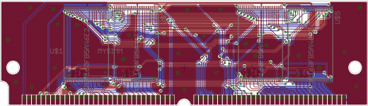

I've done a ton of manual tweaks. I'm not done yet, but I've moved many traces around to allow more of the SIMM to be covered by the ground copper pours on the top and bottom:

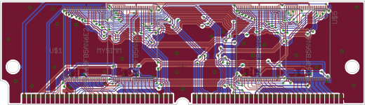

Here's my work tonight on the PCB:
It may look like the copper areas have shrunk, but that's because I increased the isolation for them to 16 mils. Before I increased the isolation, I had actually added extra copper. I'm getting pretty close to having something ready to order :)

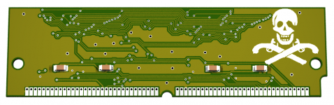

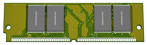

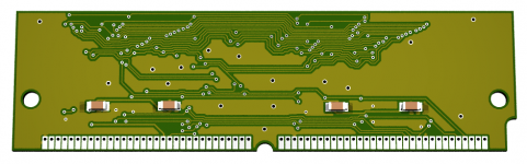

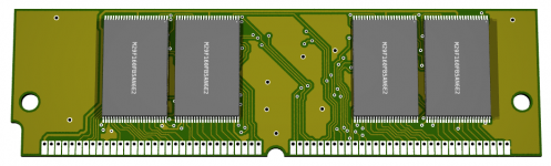

I think I'm done laying it out.
And of course here are the 3D renderings to see what it will look like:
The more I look at the datasheet for the chip, the more I'm pretty sure this is going to work. The chip can do 16- or 8-bit data mode. I force it into 8-bit mode by connecting the byte/word mode selection pin to ground. In this mode, the D15 pin on the chip becomes a byte select pin (high or low byte), essentially becoming the lowest address line.
To unlock the existing 2 MB chips, you write an unlock sequence: $AA to $555555... (filling up all of the address lines with that pattern), then $55 to $AAAAAA... (filling up the address lines with that pattern). Then there's a command set for other stuff.
To unlock these new chips, you write this sequence instead: $AA to $AAAAAA... and $55 to $555555... it's the exact same commands, but the addresses are reversed. I *believe* this is due to the extra byte select pin and my software will actually treat it correctly because the pins starting at A0 do match that pattern, but I don't know for sure. If it doesn't match, it'll be a simple patch to the programmer board's firmware to fix the command patterns for the bigger SIMM.
ARRRR!!!!! I'll be wanting one to complete me SIMM booty, matey.
I spy lots of room for the Pirates of SIMM Slottage logo, if not the LED(s) on one side, me bucko! [}:)] ]'>
How about just one LED and an eye patch? :?:
Now if someone figures out how to convince me IIsi it be somethin' else, we can Rocketize the little snark! [}:)] ]'>
I just don't feel good about the LED right now. I want to make sure the board works without anything extra. If it works OK, then in the second batch I might think about LEDs and stuff like that. I guess it's kind of the same way I did it last time.
But I did add the Jolly Roger to the silkscreen :)

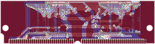

I just sent off gerber files to Seeed Studio for this new board. I cleaned a few more traces at the bottom, and I'm ready to go now. Can't wait to put one together and try it out!
This is also the first SIMM I have done with EAGLE rather than FreePCB, so it's quite a major change. Hopefully it works out OK. The generated gerbers look fine to me at first glance!
