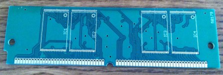

OK...I got a SIMM all assembled:
I was able to put my 2 MB huge mario startup chime ROM onto it and it worked fine booting the IIci--so I definitely wired the circuit up correctly and got the unlock sequence correct. Then I washed the board and now it's having some trouble with corrupt data on one of the chips when I flash a full 8 MB file to it. I think I just have to play around with it a bit and it will be fine. I might have a loose solder joint or something like that. It's passing my electrical test so I don't think it's a shorted pin. Once I figure out what's going on, I think it will work...the other three chips seem to flash fine through the entire 8 MB of space. And it definitely worked earlier before I washed the board.
It takes almost 8 minutes to flash the entire SIMM...so it's not very much fun waiting for it to complete when I want to test things :)
I have already ruined a PCB (lifted a pad) and one of the flash chips (broke off 2 legs) carelessly playing with different soldering techniques--I accidentally bent one of the legs and tried to un-bend it with my soldering iron...bad idea...
Looks like a small iron tip is also a bad idea...a normal size iron tip, plenty of flux, and copper braid is definitely the way to go with this fine pitch stuff. I wish I could get good enough to where I don't need the copper braid at all, but it's really tough not to create shorts on pins so close together. Despite the tiny size, I think once I have more experience soldering fine pitch components, this SIMM will be easier to put together than the 2 MB SIMM.
Edit: I found a few places where there were some questionable-looking solder joints on the chip that was causing problems, and it works now! My IIci is playing the first movement of Beethoven's Moonlight Sonata to me right now...the 8 MB SIMM can fit an entire almost-6-minute performance of it as a startup chime. Perfect way to test the SIMM out -- it's working! It's ALIVE! I can now confirm that the IIci has all of its ROM SIMM address pins wired up correctly. This is going to work! :)
