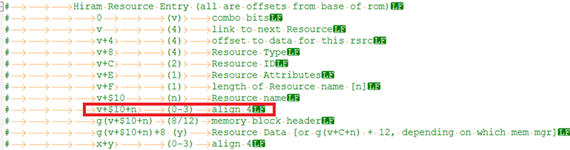

Looks to me like that's padding bytes to longword align following fields.

The resource name is variable length. The 4 byte alignment is required for the memory block header. Since the the resource name is variable length, the alignment may not always be at byte 33 and the length of the alignment may be 0,1,2, or 3 bytes, never 4 bytes.
A memory block header is the structure that precedes every pointer in the system or application heap.
Since resources are handles, the memory block header has a memTag field with the relocatable bit set (nRelTag), and a memMaster field (handle32 or handle24 depending on 24/32 bit addressing) which is a back pointer to a master pointer in a masters memory block. This is a ROM resource so it also has the nRelTag bit set (which means it is HLock'ed.
You may have to follow the InitResources function of ResourceMgr.a in the supermario repository to see how the rom resources get put into the heap. ROZInit creates a read-only zone for the rom resources (a separate heap?). Some stuff has to be setup in RAM to point to the ROM resources?

Yes, pretty sure these are alignment.
Came here to say this; oddly, I can't find the documentation that stated it.

It's in the SuperMario source code (https://github.com/elliotnunn/super...02-09/Toolbox/ResourceMgr/ResourceMgr.a#L1147)
Code:
;_______________________________________________________________________________
; Routine:        ROZInit (utility)
; Arguments:    A0        (output.L)        Handle to the Map in the ROZ
;                A2        (output.L)        Pointer to the Map up in the ROM
;                RomMapHndl (output.L)    Handle to the Map in the ROZ
; unchanged:    A3-A7,D1-D7
; trashes:        A1-A2,D0
; Called By:    InitResources
; Calls:        _BlockMove, _InitZone, _NewHandle, _NewPtr
; Function:     Builds a new zone in the system heap.  This zone is a Read Only
;                Zone.  The size of the new zone can be calculated by the fomula:
;<A291/29oct86> bbm memory manager is now long word aligned, which changes ROZinit.
;<C396/4dec86>    agh Make master pointer size 8 bytes for use with UNIX 32 bit
;                    memory mgr.
;        Size = zoneheader + zonefooter + longwordalignbias + slop
;                + (12 + block of 4 master pointers)
;                + (12 + size of master pointer block) + (12 + size of map)
;        Size = 52 + 12 + 12 + (12 + 32) + (12 + sizempb) + (12 + sizemap) + slop            <c396>
;        Size = 144 + sizebmp + sizemap    + slop                                                <c396>
;        Size = $90 + 8*X + Y+slop        ; (where X = number of rsrc's                         <c396>
;        Size = 8*(#$18 + X) + Y         ;     and Y = size the map)                            <c396>
;The old stucture of the ROM is as follows:
;        ROMRsrcStart:    (long)            ; offset to Rom Rsrc stuff
;        Rom Rsrc Stuff
;            X:            (2)        number of rsrc's in rom
;            Y:            (2)        size of rom rsrc map in rom
;            Map:        (Y)        the rom map
;            rsrc's:        (x)        the rsrc's
;The new stucture of the ROM is as follows:
;        RomBase
;            1A            (4)        offset to Rom Resource Structure Table
;        Rom Resource Structure Table
;            0            (4)        offset to first Resource Entry
;            4            (1)        maximum valid index in parameter ram [v]
;            5            (1)        Size of Combo Bit Field (v)
;            6            (2)        Version
;            8            (2)        Size of memory block header
;        Hiram Resource Entry (all are offsets from base of rom)
;            0            (v)        combo bits
;            v            (4)        link to next Resource
;            v+4            (4)        offset to data for this rsrc
;            v+8            (4)        Resource Type
;            v+C            (2)        Resource ID
;            v+E            (1)        Resource Attributes
;            v+F            (1)        length of Resource name [n]
;            v+$10        (n)        Resource name
;            v+$10+n        (0-3)    align 4
;            g(v+$10+n)    (8/12)    memory block header
;            g(v+$10+n)+8 (y)    Resource Data [or g(v+C+n) + 12, depending on which mem mgr]
;            x+y            (0-3)    align 4
;                where g(w) = w + ((4 - (w mod 4)) mod 4)
