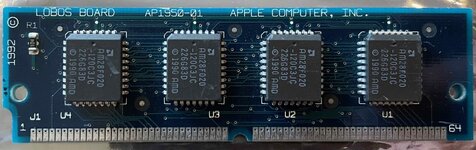

I recently picked this 1 MB ROM peculiarity up - 4x 2 Mb flash ROMs... anyone know either what this is (other than a 1992 ROM SIMM :), or an official rominator... ) or an easy/inexpensive way to dump this to find out whats on it? I've not seen a "Lobos Board" before.
The only period Mac I have is an SE/30 board without PSU, disks or display.

So one of the way would be to remove all chips and dump them with an EEPROM reader. The easiest way would be to find a compatible RAM and dump from there.
I don't have a suitable PSU for the board at the moment - could try it if that would be something to try - I have a VGA display adapter so can connect a display up.
Do I remember that you're in the UK? If so, I have a spare CRT you can have if we can work out how to get it to you safely, don't think I have a working spare PSU though. Do you have an AB?
edit: hmmmmm, I'm not sure if I've got a spare yoke or not. Will have to check...

Maybe a member here would be willing to do the work for you that has the equipment needed? That would be the cheapest and easiest way.

I’ve only got the board unfortunately.

Yeah I’m mainly interested to see what’s on the board - hopefully a developer ROM, but who knows. Will be fun if it is something interesting!

Well if you are in the UK I have access to both macs it may work in and a EPROM programmer

I was about to say I’d take you up on that, but have just realised my Interactive TV Box has a 64 pin ROM slot! I’ll have a look at that first.

I looked through all of the code names and could not find a Lobos. Which means Timberwolf. Nothing for that either. I do remember something being called Lobos, but what I can’t think of.

I wonder if it could be a prototype ROM board name, and being such, it was too insignificant to record it? So instead of a whole computer being named Lobos, it was just this ROM simm?
