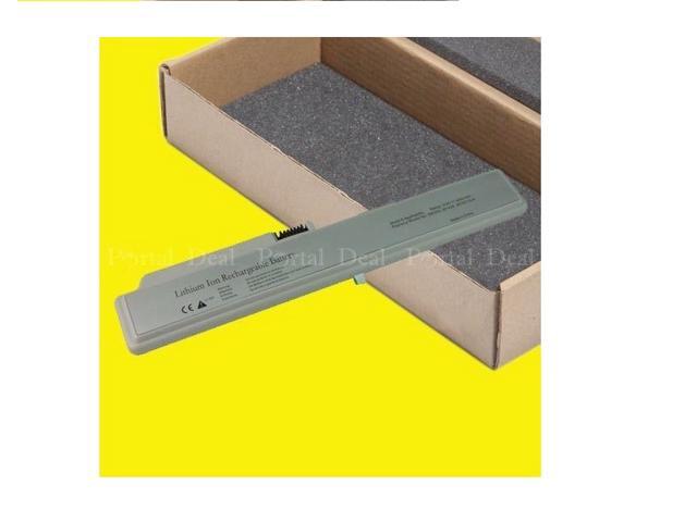

I like my iBook DV SE...the gray always appealed to me. Do we now have a proven method for rebuilding these batteries?
davidg5678
The method exists, but unfortunately, there is a lot of conflicting information that goes around when dealing with the 18650 batteries. There are several videos showing people soldering directly to the cells to rebuild iBook batteries, but according to the manufacturers of the batteries, this is dangerous and also decreases the battery life. A lot of people swear by this technique, but I have a feeling the battery manufacturers know what they are talking about more than most hobbyists do. The problem is that if there is a tiny short anywhere, it is enough to get things red hot, which melts the insulation, leading to more shorts, fire, etc. Essentially, if anything goes wrong, you can have a massive fire hazard on your hands.
I did a ton of research before attempting to rebuild my battery pack, but I still ended up melting several batteries and spending way too much money. :( I think at least for now, it is easier, safer, and cheaper just to buy an aftermarket battery pack. If the source of these dries up, I guess someone will make a bit of money rebuilding these for people who don't want to deal with the problems entailed!

I'm waiting for another battery pack to arrive in the mail at the moment, but as soon as I make a working battery, I promise to make a thread detailing the (more difficult than expected) process.
...OK -I'll describe the melted battery here too. :) What happened is that after I spot-welded the entire battery pack, I had a hard time getting the plastic shell to snap closed. It turns out there are at least two revisions of these batteries, (one with orange cells, and one with green ones) It looks like the green cell variant is easier to work with, but I had the orange one. While pressing the plastic clips together, a tiny piece of insulation must have been scaped off one of the cells, because the next thing I knew, I could see a red-orange glow coming through the almost closed plastic shell. The nickel-metal strips ended up getting so hot that they melted and acted like fuses before things could get even worse, but this was enough to destroy three of the 18650s and make a pool of molten solder fuse to a battery cell. The wires I soldered to the nickel strips fell off because the solder melted after getting so hot. The plastic casing also partially melted in this area from the heat. I hope to try again, but this scary (and really expensive) experience was more than enough to put me off from the project for over a month! I guess the main takeaway for me was that the 18650s are really dangerous, and if anything goes slightly wrong, they are enough to ruin your day!
I've also noticed that the iBook intermittently forgets the date and time after a restart/shut down. Are there any PRAM batteries I need to be concerned about replacing? This will be a school laptop, so date and time will be quite important.
I think the iBook just uses the main battery to run the clock, so getting a new battery should fix this issue. There might also be a capacitor that keeps time between battery swaps, but I cannot remember if that applies here.

Been researching this again. Here is some insanity on prices:
Darn! I had been meaning to buy one of these back when they cost $60. At $300 I guess now it does make sense financially to resume my over-budget battery rebuilding project. I'd been putting it off ever since the battery melting incident I described above, but there must be a way to complete this safely. Back onto the queue, it goes!
