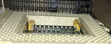

That would be interesting, but before that I have to fix what I found under the CPU.
Does not look that this should be like this...
Yikes!
Yeah it's a weird way to orientate the caps, but doesn't look like they would fit otherwise. Looks like you'd have to carefully heat and push the one side back and just reflow the broken joint.
Long as it's not lifted the pad, it should be okay
Oh and now I see C39 is displaced as well. Good luck with the repair.
I pulled mine out to compare. The cap is in a precarious position due to the sliding lock on the socket, so it needs to be tilted inward to avoid being broken off when the CPU is released. Maybe that was the cause?

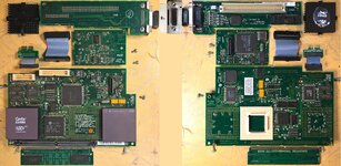

I also took some better quality photos of these Orange386 and OrangePC 290 cards.
To add to these earlier photos, a few more cards in better quality: OrangePCs 620, 340, and the LC630 version of the Houdini II board.
