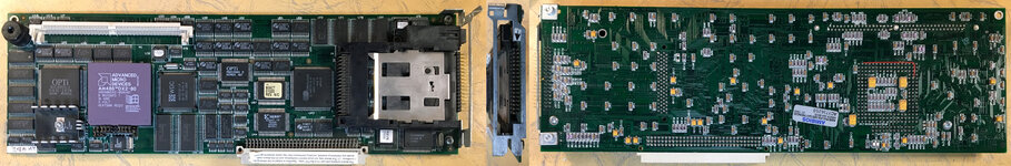

I picked up a IIci off eBay today found this installed inside.
Nice find! It'll boot from a disk image file on the Macintosh SCSI bus, so as long as you have free space you should be fine. I imagine you could add an IDE ISA card and use a physical drive, but I haven't tried or heard of this yet.
My 386 class boards use a virtual file on the Mac HD for booting plus the Macs mouse and video for control.
The ISA slot would probably be used for a network card.

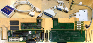

I picked up a IIci off eBay today found this installed inside. I can see it has it's own CPU and RAM, even an ISA slot for expansion, but what does it boot from? There's no IDE header to be found on the board. Does it require an external hard drive?
Could anyone point me to drivers or install software that would work with this card? I tried a few "Orange386" floppy images but the installer didn't see any card. TattleTech finds the card on the NuBus slot through.
Do you have the breakout cable for that card? That WD chip is a VGA controller, so you might need an external monitor.
Anyway you need 200 series software for that card as it is known to work from a post on VCF Forum showing that exact card.

On close inspection I noticed the ISA card bracket on the Orange386 had begun to erode the surface coating and exposed some copper on one of the traces. I added some washers in between the PCB and the bracket on reinstallation to avoid further contact.
(sadly, this was not the cause of the CMOS check hang I've been experiencing)
