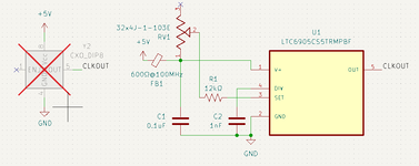

It's a potentiometer-adjustable silicon oscillator that fits in the common half-size (8-DIP) metal can oscillator footprint, based on the LTC6905. It's partially inspired by Kay Koba's Spicy O'Clock, but I can't say it's based on it, since Spicy O'Clock is a commercial product and the schematic and BOM are not public, as far as I know. It's also inspired by wiretap's Full Can Variable Oscillator but obviously does not use the Si5351. Here's my schematic:
I pretty much just followed the LTC6905 datasheet, threw a ferrite bead on the 5V input for good measure, then laid out a board to fit everything in the DIP-8 footprint. I'll publish the final version on GitHub when I'm satisfied that all the bugs are worked out.

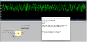

I came up with the 12k fixed resistor and 10k pot using a spreadsheet and the formula in the LTC6905 datasheet:
Because I had JLCPCB assemble these with Bourns 3224J-1-103E, a 12-turn potentiometer, it's really easy to dial them in to a precise frequency. Each full turn is approximately 2.5MHz. I bought the LTC6905s on Mouser and assembled them myself because it was a lot faster and probably cheaper that way than trying to have JLC source them.
