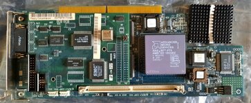

And here's the back side of the Pentium 100 and the Pentium 166 cards compared:
Comparison image here.
I think I didn't want to scan the 166, because by that time I had already put the heatsinks on the Opti and LSI chips (because they need them IMO) and didn't want to get new adhesive pads for them.

As a separate matter, if anyone has any of those little add-on Vibra16 daughtercards for the Apple/Reply cards handy, I actually need one or two of them. I think both my 7100 and 8100 PDS cards are missing them. At least one of them is for sure. The 7100 and 8100 cards actually have two sockets seemingly for some other daughtercard too, but I have no idea what for.
I don't think the Houdini Vibra module will fit on the 7100/8100 DOM cards. I've only seen one with a daughterboard, and it does have a Vibra chip, but I'm not sure if it's combined with a serial/parallel card or what else those ports would be for.
Oh, that daughtercard seems like it is a combo card of some kind? What's that SMC chip for?
I recently saw a picture of the 7100 version of the card with what looked like a Vibra16-only card exactly the same dimensions as the one on the 6100/Houdini card attached to it.
I'm getting hits for "High-Performance Multi-Mode Parallel Port Super I/O Floppy Disk Controller."
Interesting. Definitely not on the Houdini or its Vibra module.

Yeah, I think there's a way to get a proper gamut of PC I/O ports (Serial, Parallel, etc.) exposed on that thing with that flavor of daughter card. The default octopus cable only has video passthrough and MIDI/gameport (which is inactive if you don't have at least the Vibra16 board). If I'm not mistaken it connects to your PDS card using both the top and bottom sockets at the same time, whereas the Vibra16 card only attaches to the socket closest to the top edge of the card... I think.
I wonder if there's an even more filled out card; this one seems to have quite a few unpopulated headers too. The 71/81 DOM will be a much cooler card with some hardware I/O :D
Side note: it irritates me to no end that the 7100 board has a proper Socket 3 socket, but the 8100 board has only a Socket 1 socket. I wanted to use my 83 MHz Pentium Overdrive chip in the 8100, but I had to put it in my 7100 instead. It's no big deal, I just don't like the PC in my Mac being noticeably faster than the Mac itself :) .
Wait, what?! That's a detail worth mentioning in the top post too if I could edit it :)
Oh! Those ribbon headers on that daughterboard look like they're for a parallel port and a serial port, respectively. I bet if you had a PC/AT bracket with those ports on it and stuffed the other end of the ribbons into those sockets, you'd have your proper hardware I/O.
Probably so. I wonder what else *could* be implemented beyond that.
