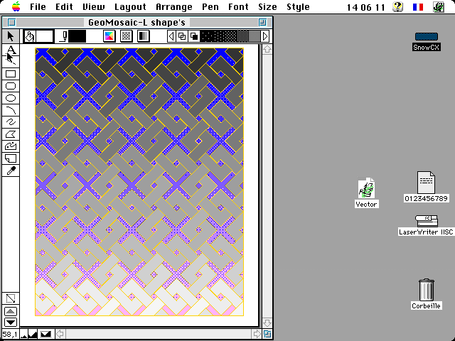

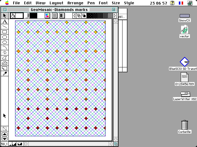

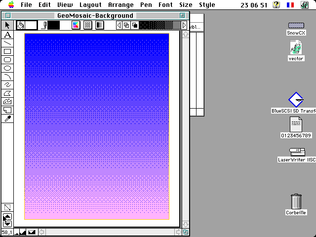

Animation​
Here is also an animation about the whole process for the GeoMosaic Sample File that is shipped with MacDrawPro 1.5v3
This sample file is a 6 layers document with vectors in each layer. Here are the screenshots of all the layers (first one is layers 1 to 4)
And here is the animation. It's in APNG format, if your browser is recent enough, you should see it moving.
The driver is drawing the MacDraw file inside the printer frame buffer, layer by layer, and applying color to black and white conversion (dithering included)
