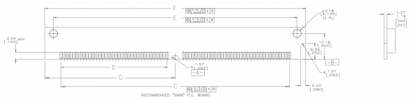

1.2mm thickness. Technically SIMMs are supposed to be 1.27mm (0.05 inches exactly) thick but 1.2mm works well enough. The usual thickness of 1.6mm is certainly too thick, I think.Are you ordering full thickness PCBs? I'd assume so, but thought it better to ask than not.
There's some tolerance so I think it'll work okay. One danger with tinning the contacts is that gold doesn't corrode and makes better electrical contact than solder and other metals. For example, it takes some force to get an accurate resistance measurement using nickel-plated multimeter probes, but almost no force is required when using gold-plated probes. So I think we're best off with just the gold pads.I've kicked around the notion of tinning the contacts on the thinner PCBs. Might doing that on one or both sides make up that 7 mil differential? Leaving off the solder mask for the contacts might just do it?

Hmm yes, I guess they are very rarely gold-plated. Either way, I don't think the layer of flux would be good for connectivity. We will look into what can be done about this, but as far as we can tell, good contact is being made.I agree completely when it comes to edge card connections, but I've rarely if ever seen 30-pin SIMMs in gold. OEM Apple ROM SIMMs are not gold plated. Dunno, maybe worth thinking about a bit? Gold's electroplated correct?

Cool beans, just thought I should stick my nose in about it in case it might be helpful. Still curious about any difference there might be in thickness between gold plated vs whatever the silver stuff might be?Hmm yes, I guess they are very rarely gold-plated. Either way, I don't think the layer of flux would be good for connectivity. We will look into what can be done about this, but as far as we can tell, good contact is being made.
It's often the case that ENIG gold-plated finish is thinner than leaded/lead-free HASL finish. ENIG is electroplated (as you said), but HASL basically means that the pads are tinned and the excess solder scraped off. Inferior HASL jobs often leave the pads a bit lumpy, with not all of the solder scraped off. Thus the board thickness can be somewhat greater, but it's irregular and can create coplanarity issues when reflow soldering SMD parts. Thus ENIG was traditionally preferred for fine-pitch SMD stuff, though there are other contemporary options for "flat" finishes such as OSP (organic solderability preservatives). OSP is an orange-colored flat finish that's cheaper than ENIG (since OSP doesn't use gold) but only protects the pads from corrosion for a few weeks, so the boards must be assembled soon after they are made. OSP has become the preferred finish for cheap high-ish density boards such as in PC motherboards and game consoles.any difference there might be in thickness between gold plated vs whatever the silver stuff might be?
