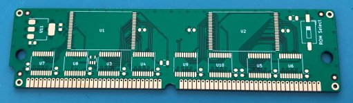

8MB SIMM boards just arrived:
I'm waiting on a single part to come and then I can assemble these.
Regarding the thickness, I was able to get a few quotes for 1.3mm boards. The best price was around $4 each, which is not bad if it solves the major issue with these ROM SIMMs.
I'm not sure why BMOW used such a thin PCB in light of the fact that the IIsi and IIfx ROMs all fit perfectly in the SE/30 in terms of thickness, with no connectivity issues whatsoever.  Meaning, if you make a ROM thick enough to fit an SE/30, it should fit those other Macs just fine too.  Maybe there was another Mac model that required a thinned PCB, I don't know.
It’s the imperial-to-metric transition that’s responsible. Original SIMMs are all nominally 0.05 inches thick, which is 1.27mm. Once upon a time, 0.05 in. was a common PCB thickness, and so was 0.06 in. (1.524mm). Now, however, metric dimensions are standard, and the commonly available thicknesses have been rounded to 1.2mm and 1.6mm. 1.6mm is way too thick, but 1.2mm is on the edge of the acceptable thickness. For example, one SIMM socket’s data sheet stated a minimum PCB thickness of 1.19mm. Depending on the type of socket used, which has some correlation with the model of Mac, as well as the thickness variation among boards, it works more or less reliably.

If ROM thickness is 0.7mm too thin, why not up the copper?  Not sure if that 1.2mm is measured from the outer edge of the front pads to the back side pads using 2oz of copper, but if it is, upping the copper to 3oz would increase the trace thickness by 0.051mm, which in turn would increase copper on both sides for a combined 0.102mm thickness increase, bringing the contact thickness to 1.2mm + 0.102mm = 1.302mm.  But again, that assumes you are measuring 1.2mm when using 2oz copper traces. The question then becomes, is it worse to have a ROM 0.07mm too thin or 0.03mm too thick?
Hmm, yes, this could certainly help. Both SIMMs have used 1oz copper thus far. 3oz is an unusual option but 2oz will at least make up half of the difference, if indeed the fabricator doesn't use a thinner core substrate to cancel it out. This will cost less than a 1.3mm board since the 2oz copper is a common option. I will try this in the future.

I made errors on my copper thickness numbers yesterday.  Since we cannot correct posts in this forum, I will just need to correct it here:
PCB Copper Thickness:
1oz: 0.035mm
2oz: 0.070mm
3oz: 0.105mm
4oz: 0.140mm
If indeed you used 1oz copper, and if your 1.20mm thickness measurement was based on that AND measured from the outer edge of the copper pads, then going to 2oz would make a thickness of 1.27mm!  Perfect!
