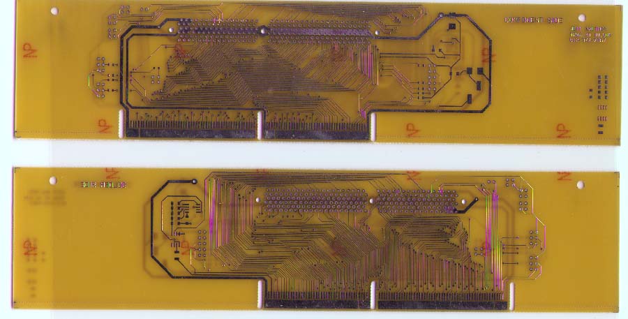

As far as building a ROM DIMM, I won’t be able to build others until someone design a new pcb board.
I just wanted to say thank you to Big Ben, John, joevt, stynx, dougg3, Eric & jocketlill.
It is absolutely amazing to see everyone come together to make something amazing happen!!!
If anyone is thinking about making a custom rom board, let me know. I was thinking of reaching out to Joe to see if we could get a blank SIMM created.

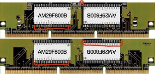

bitsavers website has PowerSurge Flash ROM pictures and schematics.
http://bitsavers.org/pdf/apple/powerpc/PowerSurge/ROM_Flasher/

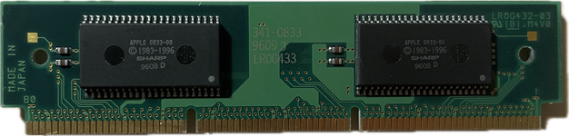

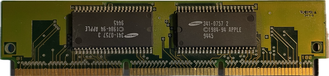

I still have a working ANS ROM SIMM that boots MacOS 8.6 and I guess MacOS 9.X (I haven't tried that) and I would love to make additional ROM SIMMs for anyone that wants one. I just don't know how.
First question, from this thread I see the images of the Flashgordan board. It appears that is was made my Apple, correct? Is there anyway to obtain one?
I have 32 AM28F020-90JC that I got from UTSource. I had planned on flashing them one by one because all I have is a TL866II Plus. If the Flashgordan board is available it would make dups much easier. I also received a different ROM SIMM from ClassichasClass that has 4 ROM chips (2 on each side) and if that can be flashed with the ANS MacOS code all the better.
Lastly, I don't remember or can find the OF commands to determine the exact ROM version. Would you mind helping?
Probably not. You probably have to make your own or use a different flashing method.
Do you know if it's 5V or 3.3V? Is it 4 MiB? Since it only has 4 chips, it's probably not programmable by Apple's Flasher utility without creating your own flashing code. Apple's Flasher utility is useful only if you can boot with the ROM SIMM connected. If it's in the ROM SIMM slot, then it needs a bootable ROM to already be flashed, or it needs a switch to switch between two versions of ROM. The Flash Gordon board connects to a different slot (NuBus?), and the flashable ROM SIMM connects to that.

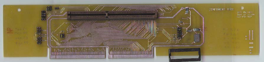

Heh. I tried to make an ANS to Mac CPU card adapter back around 2000 - 2001. Didn't work, but then my skills at the time were rudimentary. Might be worth another try. To begin with, it should be at least a 4-layer board. But back in 2000 4-layers at that size would have cost well over $1000 for a prototype.
Wow.
I won’t call that rudimentary!
That would be a nice adapter to have, but I suppose the socket is hard to obtain nowadays…

The through hole socket, which that design used, seems to be unavailable. I knew a source as of a couple of years ago and posted it in a Tinkerdifferent thread. Either the supplier got rid of them, or someone bought up all the stock after following my link. Similarly for the surface mount socket, but I found a large supply of those at a different supplier. Won't be mentioning where...
Ya know I was thinking the other day about if the normal Mac style processor cards would work, this definitely tells me it wouldn't just be plug n play hahah.
If you ever get a more modern design made, definitely let us know, wouldn't mind using a 400mhz card haha!!

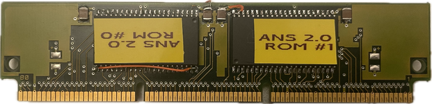

So as per the tinker different fourm post, and my own findings, the prepro roms (1.1.20.1) will be better for speed, than the 2.0, because the 2.0 roms dont address cache properly.
That being said the 2.0 rom is much more stable, and makes the internal scsi, internal gpu, and internal networking work, whereas the prepros don't.
My major usecase is Debian, so hopefully it makes that faster. i have a 128 n ethernet card, so imma do the prepros.
Perhaps the ROMs can be reverse-engineered and the 2.0 ROM can be fixed to properly address the cache?
c
Im sure this is reasonably trivial for some of the folk here, but i think the biggest issue with doing that currently, is that no one has a rom sim that has hotswappable chips yet. along with most people not having the specifc programmer or whatver.
In other words, the ability to program a chip exists, but not in an efficent enough way to make it easy enough to be worth.
Currently that would have you desoldering chips more than once, and from my experience the roms will pull pads easy, so its just not easy rn.

i ordered some rarer socket type things for the rom chips, trag has mentioned they havent gotten them to work, but i think pressure is the issue and a binder clip would solve any issues.
I wouldnt mind the look, for the ability to not have to solder any new chips on. according to trag, the rom boards realllly dont like getting soldered on more than once, at least via heat gun.
Both in mine and his, its been found that at some point the board will just...not work, even though visually everything is fine.
I plan on making remakes of these boards with we# and reset# tied to Vcc already, so all you should have to do is solder chips on.
