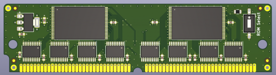

My friend and I recently made a batch of 2MB ROM SIMMs for the SE/30 and Mac II machines. We wanted a few of these ourselves as well as to sell through our little company (price will be $25 incl. domestic US shipping):
We have also finished a design for an 8MB ROM SIMM (actually it holds two separate 8MB images) using cheap 3.3V flash (price will be $35):
