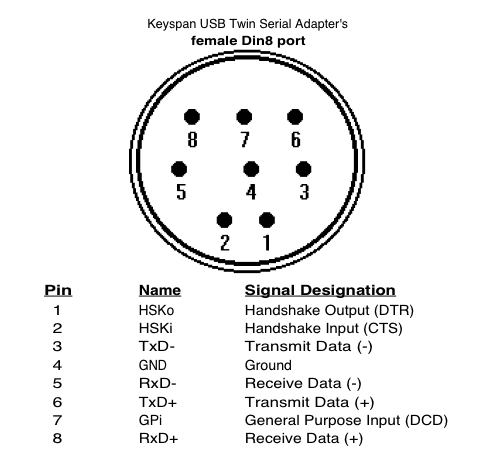

The 8-wire cable will be here sometime today, and then I'll work on the pinout for both ends. The DE9/DB9 is the easy part, finding the correct Mac based 8-pin Serial pinout may be a challenge, I'm finding conflicting info on that for some reason.

That DIN-8 diagram looks like the same one I used to use; I recall that there was a diagram floating around with TX and RX flipped for some reason; I think it was meant to be for wiring up a null modem cable, and someone got confused. But I haven't messed with that in around 27 years; best to test with a multimeter.
The reason that the labels are different for pins 6-8 is that their function changes depending on the protocol being used.
Making this Tech Step cable has not been easy, still not getting a connection from either the SE or SE/30.
As verified with a continuity test.
DB9 = Din-8 pin color
4. DTR = 1. Black
8. CTS = 2. Brown
3. TXD = 3. Red
5. GND = 4. Orange
2. RXD = 5. Yellow
7. RTS = 6. Green
1. DCD = 7. Blue
6. NC
9. NC

I'm now wondering if my DB9 was wired backwards, because I'm using a female connector, and the diagram shows the male pinout. The COM port is male for the PC.

This is the diagram I used to construct my working tech step cable I made for my SE/30 - using similar green DE9 breakout connector like you are using:
I cut the end off an extra imagewriter II cable I had and put the DE9 breakout on. Try using a multimeter to confirm continuity for pinout described below?
I got the above instructions from https://adtpro.com/connectionsserial.html
