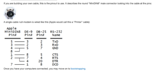

This is the diagram I used to construct my working tech step cable I made for my SE/30 - using similar green DE9 breakout connector like you are using:
I cut the end off an extra imagewriter II cable I had and put the DE9 breakout on. Try using a multimeter to confirm continuity for pinout described below?
I got the above instructions from https://adtpro.com/connectionsserial.html
I gave that pinout a try, and there is still no answer from either the SE or SE/30.

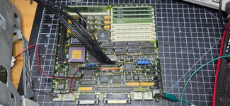

Toned out the entire Address and Data pin matrix, all lines from the ROM/RAM/CPU are connected still, and all I get is:

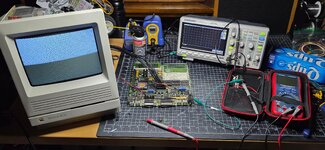

Using the scope to probe the address lines in the PDS socket, with no ROM installed, did not show any clean square clock, not "walking the bus" as far as I can tell.

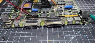

Looks like the bodges won't be difficult to get connected again. The red line is GND, and can be patched in to the via above it, tested and proven. The green bodge doesn't have far to go either.

I went through every data and address line, not only from the CPU socket, but to the PDS slot and then the locations on the board itself - all lines are connected. I checked the crystals, and found the correct clocks.

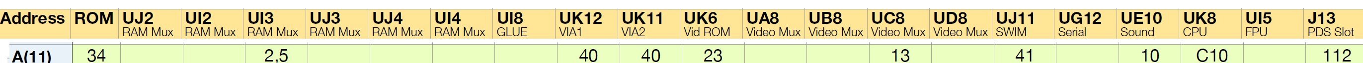

Printed out the Address and Data line matrix and went through all of the UE10 pins, back to the ROM slot.
On the very last pin to be checked, I found a problem with pin 10 of UE10, it was not connected to pin 34 in the ROM slot, all other pins are connected, both Address and Data.
