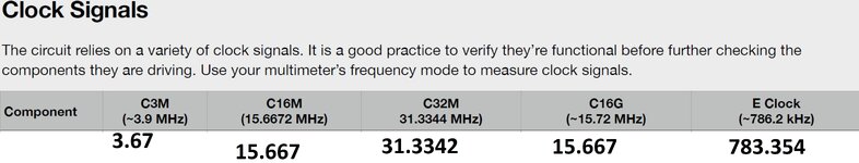

Went through the clock signals and not sure what to make of this.
The C16G clock running the same speeds as C16M seems odd since all of the C16M clocks were exact. The E clock is off too.
But the strangest is the C3M clock wave form, when compared to the others, this is C3M running slightly slower than the expected 3.9MHz:
C3M looks like a stutter, or overlapping signal, is there something off here?
I did setup my scope better, I guess I won't worry about the slightly slower speeds 3.67MHz vs. 3.9 Mhz, all the clocks are where they're supposed to be.

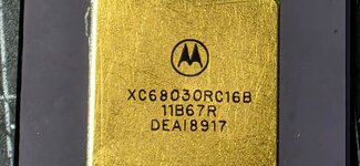

Tried the CPU walk the bus test and I can't get a square wave from any of the ROM slots, the wave form is a mess, with varying speeds, nothing is consistent.
Is there any way to tell if a CPU is bad without another one to test with?
Going to have to try ordering another CPU, want to replace it with the same I already have.

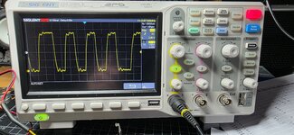

Found an issue with my Y3 Xtal, and was wondering if this is normal.
On the Y1 Xtal I get a matching wave form on both legs with a clock of 32kHz:
But on Y3, that is close to the UE10 chip that was corroded badly from the cap leak, I get a strange looking waveform on one of the legs:
The good signal from the leg farthest away from UE10:
The other leg closest to UE10:
When I look at the schematic I see both Y3 legs are attached to UE10, Xtal In and Xtal Out. Should both Y3 wave forms be exactly the same, like Y1 is? Does Y3 go bad?

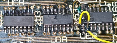

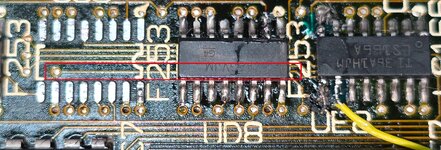

Just catching up with this scary SE/30 thread... It really looks like there are too many rotten traces here, but... Did you really bridge green pad on UE8 to the UD8 pin 15? I'm not sure that's right. Original Apple schematics show that green pad to be "VID(4)" signal, connected to pins 2 on both UC6 and UC7 (on-board VRAM I guess).
Apologies for shrugging this excellent observation off, I wasn't thinking clearly and was overwhelmed by the scope of all of this LB's problems, you were exactly correct, UE8 does not go to UD8, it was supposed to go underneath UD8 and UC8 to where a hidden via is located and then on to the backside of the board.Removed UC8, then corrected UE8.
Not pretty but new UC8 is fully functional and so is UE8 now.
Removed the second jumper wire after testing.
But that didn't fix the simasimac condition.

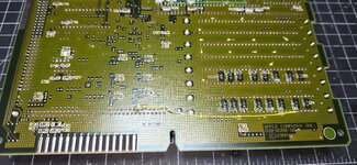

What finally did though, was finding D(1) was missing from underneath the aftermarket CPU socket I added, touched up the pin and then noticed D(1) was still missing from the ROM slot, pin 15. Had to bodge Diode 6 Pin1, to ROM pin 15:
And just like that - BONG!
