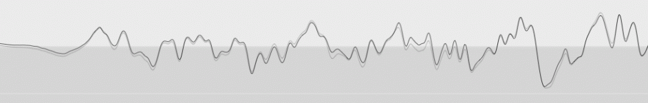

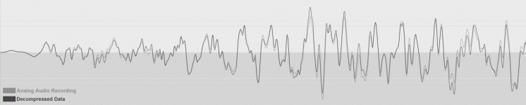

I have it to the point where it sounds good now, but it is not perfect by any means when you start comparing the waveform to an actual recording. It's in the very nature of this integration-type decompression to propagate the slightest error into something huge. I believe that it could be perfected, assuming that the sound chip accomplishes its decompression with a completely digital circuit, but I also believe that it's good to realize the point when something becomes good enough to consider moving on.
