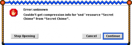

It just so happens that this is PRECISELY where I trimmed the "snd " resource before. I saved it into a system 7 sound file and tried opening it in sndSampler, and I got an error (see attachment). I named this file "Secret Chime" - so that name didn't get extracted form anywhere. sndSampler needs some sort of extension to use some compressions, though, and it complains about this when you try to import raw audio manually. So I'll see if I can find something in the manual. The manual is pretty sarcastic, so I think a quick skim might be in order.

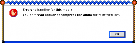

Attached is an image when I try to import raw audio using compression in sndSampler.
