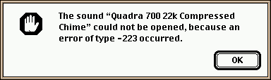

I attempted packing both of the compressed sounds into a system 7 sound file and playing in Basilisk II running on the Quadra 700/900 ROM and got the attached message. The OS clearly intervenes. Attempting to play the startup sound with the BootBeep control panel results in a crash, somewhat as expected.
