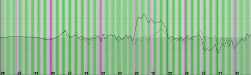

Have a look at this fine specimen. At the transition from one packet to the next, if the type of wave changes, the tail end of the wave transforms into the tail end of the new wave type. VERY interesting. I'm not sure how it connects the waves together yet, but it does appear to be a smooth transition.
This all makes me wish I understood my control systems classes a little bit better.
When these wave "pulses" build on each other, they don't just add together. There's more to it and I can't quite figure it out. There is some strange stuff happening here.
Type 1 mode is:
Next sample = current sample * (15/16)
And nibbles are instantaneous offsets of the current position of the wave I think.
It could very well be that Type 2 is a filter on top of type 1.
Type 3 (sinc) might be best saved for last with this approach. But it DOES appear to follow type 1 in amplitude.
I'm trying to think in terms of piecewise functions - it seems like a chip like this would do simple calculations based on a very short history of the sound, and won't keep track of the sound very far outside of the current position of the sound wave and the current nibble. So for example keeping track of an entire equation and repeatedly feeding through an exponential function from a set starting point is not likely.
Type 3 mode is pretty much a sine wave that uses type 1 mode as an envelope. The exact frequency and starting point of the sine wave is still unknown.

You can see that this method is not perfect in the image. The yellow line should be on top of the black line.
edit
I was using the wrong scale. In the new image, both are 28 samples, and it's possible that this is correct considering the high-pass on the black lines.

I have plotted out the beginning of the normal startup chime. The dark line is the one that went through my program, the lighter line is an audio recording of the Quadra 700 playing it, magenta stripes are the first nibble in a packet, green stripes are the other nibbles, and the number printed on the bottom is the header byte of the packet. The left nibble of the header byte designates the wave type for the entire packet.
As you can see, there are some issues here. It seems that both of the big bumps happen right at the transition from one packet to the next.
