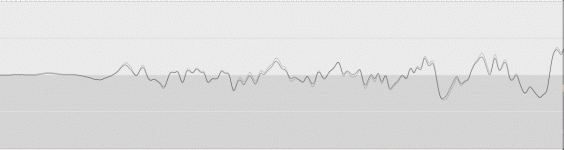

I booted System 7.5.3 on the Quadra 700 and played the 16-bit sound file. It played fine and when I compared the recordings, I noticed some things:
- Sound control panel states 22.254 kHz, 8-bit sound output
- No visible extra resolution (i.e. 16-bit vs 8-bit) (may not be visible even if it exists, dunno)
- Visible differences from decoded version.
- decoded version played on Quadra sounds more noisy than BOTH BootBeep on Quadra and decoded version played directly (not through Quadra). I don't know what this means. It's a qualitative observation.
Gray line = original startup sound played via BootBeep on the Quadra, Black line = decoded 16-bit startup sound played through the Quadra.
Hmmm. It's very possible that the Quadra 700 only supports playing 22.254 kHz, 8-bit samples when you feed it raw data so the Sound Manager is doing the necessary conversions. This would be similar to the IIci sound chip behavior. Could that explain the waveform difference and noise? Just an idea.
That could be. I initially had the sound set to 22.254k and it played in the wrong tune when compared to BootBeep so I switched it to 22.050k and then it sounded right. You would think that both must be scaled up to 22.254k then.
I guess it depends on if the Mac scales the sound data to a set sample rate of 22.254k or if it actually scales the sample rate of the sound chip to the sound. Maybe the sound chip has its own clock oscillator that it can modify.
Interestingly, because the encoded sound is decoded directly inside the sound chip, and the chip seems to control its own buffering system (flags, internal shifting, etc), there must not be any intervention from any other part of the Mac to scale the sound data, at least in decompression mode. Does this mean that the sound chip runs at a sample rate "up to" 22.254 kHz, and that some command can specify a different rate? I bet that the commands that initialize the sound chip not only get it into decompression mode, but also tell it to run at 22.050kHz.
