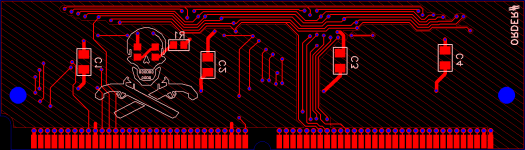

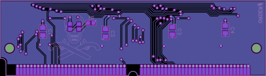

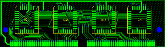

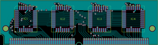

Apologies for the lack of updates! Today I was finally able to sit down and (I think) finish up the version 2 SIMM.
Changes since the last revision:
  • Pin 46 of the SIMM is now unconnected (it's labeled as +5V in Guide to the Macintosh Family Hardware, but A23 in the IIsi developer note). This change should ensure compatibility with the IIsi while maintaining compatibility with all other machines.
  • Pin 13 of the SIMM is repurposed as the write enable pin, which should allow external programming now that I have broken it apart from VCC. Both GTTMFH2E and the IIsi developer note label it as a +5V pin, and I can verify that it is connected to +5V on my IIci. When in the machine, it will be pulled high, disabling write access to the SIMM. When out of the machine, it's separated from the +5V pins, so I can control it for programming. This is preparation for compatibility with my next project, the SIMM programmer board.
  • Pin 63 of the SIMM is now connected to +5V (it used to be left unconnected). It's labeled as +5V (chip select 1) in GTTMFH2E and the IIsi developer note. Because it had a special name, I wasn't using it, but since I've had to abandon two other +5V pins, I decided to use it now so I still have two +5V pins in use.
  • olePigeon's awesome logo is in there, along with two red LEDs for the eyes and a resistor for current limiting! Since I didn't want to upset the jolly roger logo, I didn't leave any polarization markings or labels for the LEDs-- but it's easy enough to figure out which direction the LEDs are supposed to go with a continuity tester.
  • I moved all the SIMM contact vias up and made them bigger, so if necessary we can use them as a programming header. This should also let us use the SIMM board as a "dumb" board for ribbon cable connections to a bigger board (if no chips are soldered on).
  • I cleaned up the copper fills on the top and bottom of the board.
Assuming nobody catches any showstopper problems or extra suggestions (maybe some text on the silkscreen somewhere?), I'll be placing another order in the next day or two!
Edit: Hmmm, I just noticed the middle ground fill is not connected to the rest of the ground fill anywhere -- I should probably figure out a way to connect them all. That write enable pin is the culprit responsible for the detachment.
Edit 2: I did some tweaks on the traces on the leftmost chip and now the ground fills are happily connected together. Only had to add one more via. Not gonna bother posting more pictures of the changes. But I will post the FreePCB project file for others to mess with (later)!
