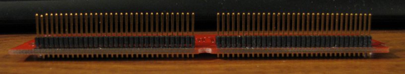

Update time! I just received my tracking number for the PCBs today from Seeed Studio, and lo and behold, they were out for delivery. So with an order placed on Monday, Oct. 17, that was a 9-day turnaround with the UPS shipping. UPS claims it was shipped on October 24th, so it only took 2 days to arrive here (well, except for time zone differences, so I don't know for sure). Anyway, very nice! Seeed must not have been feeling quite as generous, since I only received 10 this time instead of 12, but since I only paid for 10, you won't hear any complaining from me!
They arrived on the same day as my hardcopy of the Steve Jobs biography from Amazon. Coincidence, or is it a sign from above??? ;-)
Here are the revision 2 PCBs:
Looks like they turned out nice! I love olePigeon's jolly roger graphic -- with the LEDs it's going to look AWESOME. I wonder what the PCB manufacturers thought when they saw that? ;-) The vias are, in fact, big enough for the header now:
You'll notice the second pin from the left is shorter -- I believe this is from me pulling it in and out several times to test stuff out. The header has to go out from the back side with the graphic and capacitors, because if it goes out the front, the IIci's cache slot is in the way when you try to insert it. If other motherboards have similar clearance issues on the back side, I may have to abandon the programming header idea. But I'm hoping to make it work with 64-pin SIMM sockets anyway. :-)
I haven't done any electrical testing, so I may do that just to confirm Seeed Studio's testing, and build one soon! Unfortunately I didn't expect the PCBs to arrive so quickly, so the resistors and LEDs are still en route. Still, I should be able to build one and leave the LED circuit out just to test the functionality. And who knows, maybe the extra parts will arrive soon anyway? We'll see when I get around to building one!
Unfortunately, at least one of the SIMM PCBs is not testing OK -- I'm finding several instances of adjacent pins being electrically connected together. It may have happened after I increased the size of the vias above the SIMM contacts to make room for headers to fit. (This was one of the untested boards--one of the tested boards I also looked at does not have this problem). I'll have to try to physically find the problem, and hopefully it's fixable with an X-acto knife! I couldn't find anything after a quick inspection but I'll look at it more thoroughly tomorrow. This means I'm going to have to test every (un-marked) board before I assemble it.
